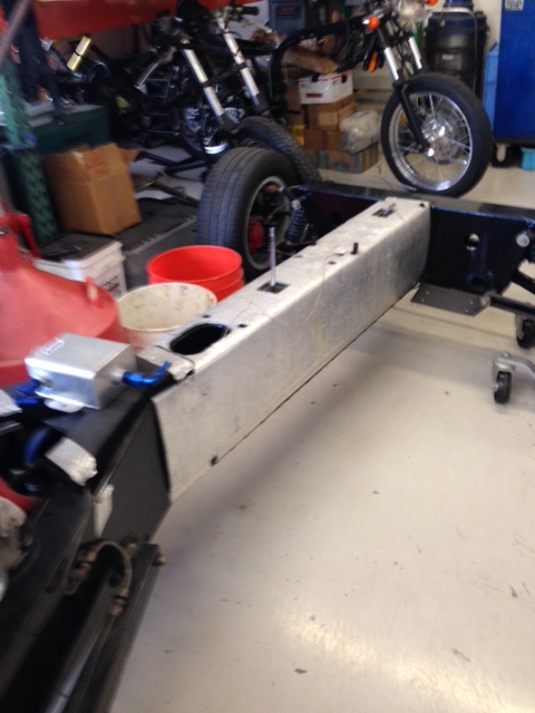

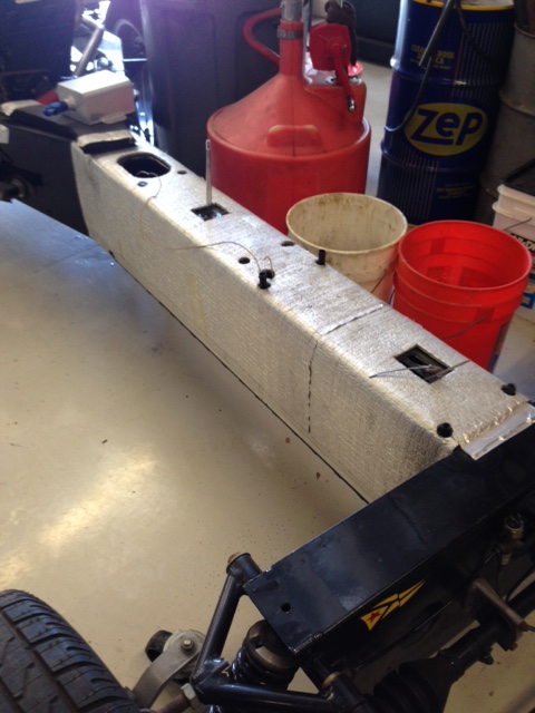

Find some closed cell neoprene foam. r.d. enterprises on this side of the pond sells some. I found some locally by checking the phone book. I used a 3/8" thickness.
Re: Soundproofing Chassis
« Reply #2 on: Friday,September 04, 2015, 02:51:55 PM »
I used a silver backed closed foam.

B-Quiet:
http://www.b-quiet.com/products/b-quiet-ultimate-50sqft
And then put the rdent.com closed foam.

Some great ideas there thanks. I've ordered some sheets of neoprene.  I'll post pics on my restoration thread.  Thanks
