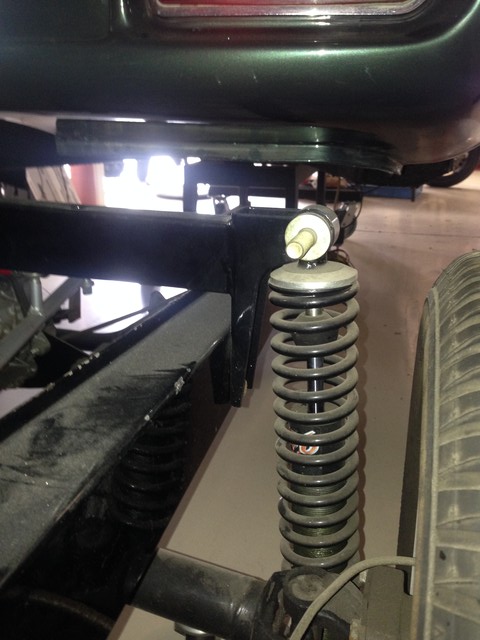

i've been looking at this for over a year, and have convinced myself this crossbeam has been modified.
seems a method of raising the rearend, or something?
was it notched and bolted lower on the chassis?
I think you've hit the nail on the head there, comparing with my TC it is mounted higher on the chassis. It looks like someone's drilled an extra hole and reduced the gap between the crossmember and the chassis leg.  Just exactly why someone would want to make a Europa look like Starsky & Hutch's Torino I'm not sure, I can't imagine it does the handling any favours.
One other thought did occur to me, that if the S2 and TC crossmembers are different dimensions then someone might have altered a s/h spare to fit and that's why it's been hacked about ? The S2 & TC have different part numbers, but whether that's just because of the bracing the TC has or if it's dimensionally different I don't know.

« Reply #316 on: Saturday,April 02, 2016, 12:48:58 AM »
the "starsky and hutch" look was pretty popular in the '70's, but i was playing with vws at the time, so i missed out.
i can see cutting it up again, and glueing some new steel in place, then bolting it back where we figure it really should be....
other than the bracing, how different could the tc xbeam be?(this is ignorance speaking).
nice picture. thanks, it helps.
richard

« Reply #317 on: Wednesday,April 06, 2016, 12:07:33 PM »
I checked my car this morning and my cross member is clearly mounted higher. Mine is a 73 TC, so maybe the crossmembers are different  :confused:

« Reply #318 on: Wednesday,April 06, 2016, 06:33:54 PM »
that is clearly how mine would have looked, with what was cut away.
i am keeping a lookout for appropriate material- i should fit it into my drivetrain planning.
that all looks way clean and neat.
thanks for the thoughts
I didn't notice this before but your crossmember looks much lower than mine did (I have Richard's twin link and so a different crossmember now). Mine was like Joe's.
Re: new member
« Reply #320 on: Saturday,April 09, 2016, 08:44:51 AM »
It does look different from Joe's and I can't offer any explanation why because as far as I know every TC has the same bit there.  This is the one that came with the car and I've not made any mods to it, the bolt holes in the chassis & crossmember are as they came.  Lotus eh ?  every car a little adventure......
