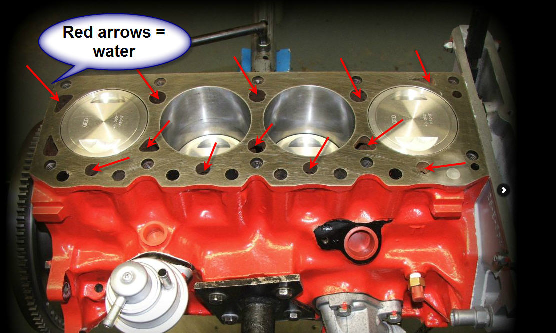

Hey All. Would anyone be so kind as to label which holes in the Europa TCS head gasket are for oil and which ones are for coolant? I've included a picture, which I've already labeled with B's for Bolts. Please label O for Oil and C for Coolant and then repost the picture. THANKS so much!

I don't have a TC engine so without looking at the head, I would guess that the small holes are oil and the big ones are water. In fact, I feel pretty sure that's right but I can't confirm that.
If you have a head, maybe you could push a pipe cleaner or wire through the oil ports to the deck of the head and tell for sure.
Good luck!

Looking at the Parts manual, it's pretty clear that the gasket only goes one way. There are two holes that go with each cylinder that should be for pushrods when the Pinto or Cortina head is used. Those would be the ones that are part of a "bulge" at the top of the gasket in your picture. Putting that gasket on incorrectly should be pretty obvious as the pushrod part would stick out on the exhaust side of engine.
I've crudely drawn arrows on the first picture to point to where the pushrods would go if they were used.
And then I drew even more crudely drawn lines to the pushrod locations in the block. The snippet of the picture came from the parts manual.

I did find some information on a modified head gasket that relates to oil passages.
More detailed information can be found here.
http://faiauto.com/lotus-twin-cam-evolution/
Re: Head Gasket Holes
« Reply #7 on: Wednesday,October 15, 2014, 10:22:06 AM »
I think I stumbled onto some more information. Here is what I've been able to figure out.
Again there are a lot of pictures and information here.
http://www.wilcoxengines.co.uk/twincam%20gallery%20page/twin_cam_gallerypage.htm

WOW LotusJoe and BDA! Thanks for the great posts! :coolpic: My 73 TCS is up and running fantastically after being torn apart for over 1 year. Last summer I had previously installed a new synthetic-type head gasket from RD Enterprises, but found it leaked oil and coolant profusely from, literally, everywhere. I diagnosed the problem as improper gasket sealant, but to be safe I ordered the typical "copper sandwich" style head gasket from RD Enterprises instead of the new style one again. I also used the proper sealant this time. The oil leak from the head gasket persists, from a section above the starter. The head may be warped. It runs now, quite well actually, so part of me just says to ignore the oil leak, BUT the better part of me says I should tear down again and get the head measured for warp and remachined if necessary. If I do go that route, I'm going to buy one of the FAI gaskets you posted LotusJoe.
