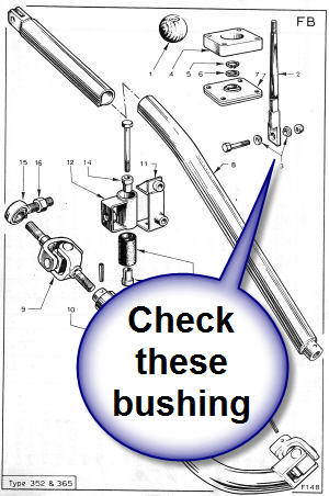

Welcome to the forum. The above replies have covered the areas of slop and wear in the TCS shift linkage. First of all there should not be any looseness between the two linkage tubes (1&2) in your picture. If you're going to work on your shift linkage, might as well be systematic about finding all the worn areas. This is what I would do. Start from the shift lever and move back.
1. In the cabin, grab hold of the shift linkage tube inside the chassis and see if there is any slop in the shift lever.
    There should be no play. If there is, replace the shifter bushings per Joe's drawing.
2. Next move to the intermediate joint where the linkage tube attaches to the bell housing. Try to move the linkage
    around. Again there should be no slop anywhere in the u-joint, heim joint and the bracket on the bell housing
    side. As far as I know the threaded u-joint connecting the two linkage tubes were Loctited on. If the two linkage
    tubes are moving rotationally relative to each other, time to disassemble and find out why. In one of my pictures
    a PO had drilled and installed a pin in the linkage. Another wear item is the bushing on the bracket attached to
    the bell housing shown in Joe's drawing.
3. The final area is the joint attaching the linkage to the transmission selector shaft. Check that the roll pin is tight in
    the hole with no slop.
If you have to screw around with the intermediate u-joint it might be easier to remove the entire linkage assemble rather than working on it under the car. Just a thought.
