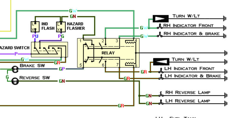

Check for power on the Green/Purple wire on terminal 5 on that relay, when the brakes are pushed. That is the trigger in.
This in turn should trigger the relay to give power to both Green and Red, and Green and White wires, terminals 3 and 7 on that relay.

If I am laying on my back under the dash, head against the firewall, looking up at the relay (the ends of which peak out from behind the steering wheel bracket, the middle terminals look very hard to access with relay in place), what is the orientation of the terminals?
Wiring diagram indicates 1 and 5 are on the extreme left, 4 and 8 the extreme right.
Laying there I'm looking up at the relay and see the metal housing. Is that the same 'view' as on the wiring diagram, or is the diagram looking at the relay from the other side?
Thanks
Re: brake lights
« Reply #19 on: Tuesday,June 03, 2014, 11:05:31 AM »
You will have to trace them through the colours:-
1 is green/brown     5 is green/purple
2 is green/white      6 is green/red
3 is green/white      7 is green/red
4 is green/white      8 is green/red
You need to find if 3 and 7 are active as those go to the red RH and rear LH brake light, respectively.

I do see that in the wiring diagram bug, ahh, there is the conundrum, I am partially color blind, so I was hoping to match the orientation of the terminals on the actual relay with those in the diagram.
And since I know that power is leaving the switch, I'd probably test 3 and 7 first. If the juice is going through the relay, but nothing lights, and the bulbs are ok (as evidenced by functioning of turn signals) then I know that there is a break in each of the lines heading back to each tail light, as they are independent of each other. I think it's a long shot that the only two wires a mouse chewed through would be those two lines.

« Reply #21 on: Tuesday,June 03, 2014, 12:07:58 PM »
Does this help?

« Reply #22 on: Tuesday,June 03, 2014, 12:29:26 PM »
Does this help?
That's the ticket, thanks! You could be doing something else with your evening, thanks for your help!

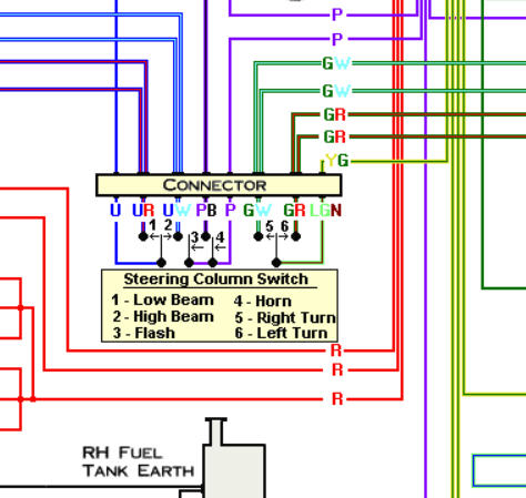

« Reply #23 on: Tuesday,June 03, 2014, 03:47:45 PM »
« Last Edit: Tuesday,June 03, 2014, 03:49:59 PM by LotusJoe »

« Reply #24 on: Tuesday,June 03, 2014, 06:50:34 PM »
Thanks, Joe. I've been studying that very diagram from the KB.
