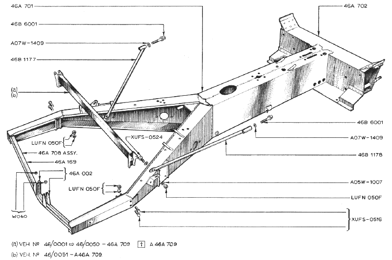

Re: Another 46 to 47 project!
« Reply #159 on: Thursday,November 24, 2022, 08:15:23 PM »
This diagram shows a clutch abutment:
It's the bracket on the chassis just above the RH 46B-6001.
It's not accurate as S1s never came in RHD but the illustration shows you roughly where it will be on the left side.  You will have to drill a hole in the raised floor section under the driver's seat base.  Use a hole saw.  You have to be able to get your hand in so make it a good size.
« Reply #160 on: Thursday,November 24, 2022, 08:22:52 PM »
JB is the abutment the tab located near 46B-6001? That looks like it may be it...
Have you had to fix the front abutment on an S1? Did you have to cut into the seat to access it?
