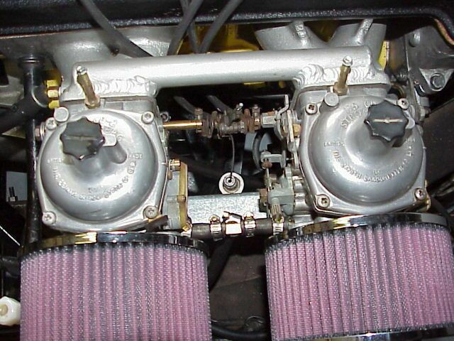

Maybe something like this?
Somebody has welded a balance pipe to the head casting and bolted the carburetters directly to it. Probably works OK< but not normal!

« Reply #7 on: Thursday,October 17, 2013, 07:10:10 AM »
Here is another solution. I know I've seen a setup very similar to this except the crossover tube goes all the way across.

« Reply #9 on: Thursday,October 17, 2013, 08:40:33 AM »
And here's mine!

« Reply #11 on: Thursday,October 17, 2013, 09:04:02 AM »
Roger, that's the one I was looking for. I remember someone used to sell that manifold, but haven't seen it in years.
Joe, that's the standard Lotus TC inlet for Strombergs, as sold everywhere except for the Federal versions of Elans and Europa TCs. Mine came from an English Elan in fact.

Re: Intake Headers
« Reply #12 on: Thursday,October 17, 2013, 09:31:09 AM »
Well that makes sense. I just realized in my first post I thought it was connected with a rubber hose, I now see that the rubber hose is there to prevent rubbing from the throttle cable and is the same setup as the other 2.  :confused:

« Reply #13 on: Sunday,October 20, 2013, 10:42:16 PM »
Roger is right, the high balance pipe intake manifold is (or was) std for European Twin Cams with Strombergs.  I have one on my S4 (bought from the UK) and was under the impression that they are getting a bit hard to find.
Some enterprising PO added one on my Europa using stainless steel pipe fittings on what I assume is an early Stromberg intake manifold prior to the introduction of the crossover pipes (Roger, if you recognize it, pls comment).  The PO did a nice job of removing the secondaries by cleanly welding closed the holes where the shafts pass thru.
