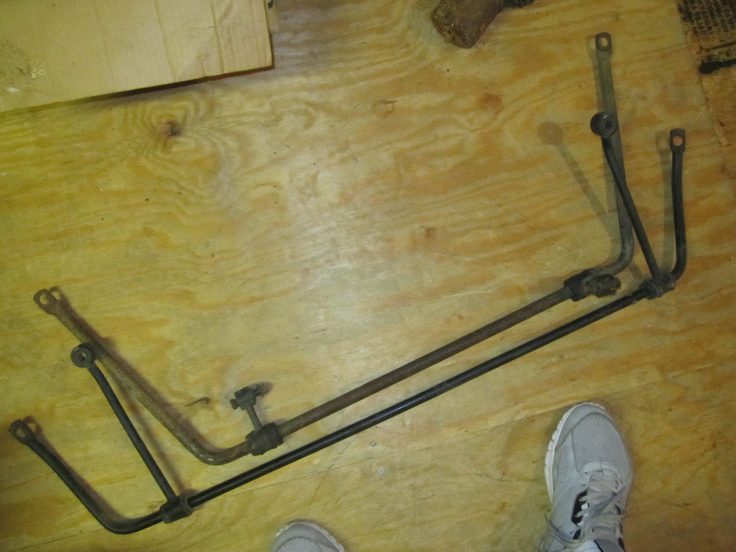

I cut the ends off my anti-roll bar and sanded/filed the end round so I could slide
the adjustable end link clamps on that I made. Painted the bar and started cleaning up
my rear Koni's so I can take them apart.
The more I do the more I find I need to do....remember your ABC’s …anything but chinesium!

I like the sway bar. Adjustable is nice. Did you mount it off the upper control arm bolt?

Adjustable anti-roll bar end link....
The Heim joints and adjuster are in tension/compression, so they should be OK.
With the upper and lower bolts in single-shear, will that become an issue?

Clifton, yes mounted with upper control arm bolt.
CW….I will keep an eye on them….they are grade 8 and 3/8”
