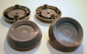

I think only the Twinks came with Lotus alloys. I found my center caps in the car (thanks Dad).  They are gray plastic and only held on by four wimpy tabs.  I assume they fall off quite easily.
RD sells the blanks, without the Lotus emblem.   You can see how they wouldn't be very secure.
  http://www.carpictures.com/vehicle/05EQN514403993/Lotus-Europa-wheel-center-cap-1973#

Spot on Mark.......".wimpy tabs" is correct.  A few on- offs then they need a "sillly cone" type of glue to stay on.
I bought some from Ray, and before I stick on the decals I intend to drill a hole and insert a thin bolt, long enough to reach inside the wheel to a hole in a strip of 16 ga steel about 1/2" wide  that sits on a convenient ledge. That way they won't fall out!
