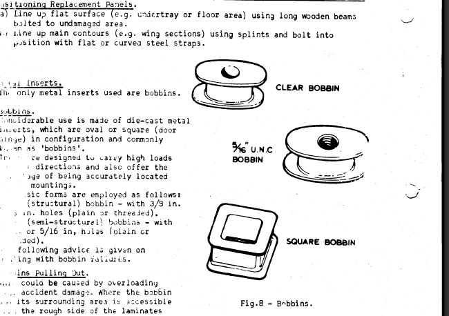

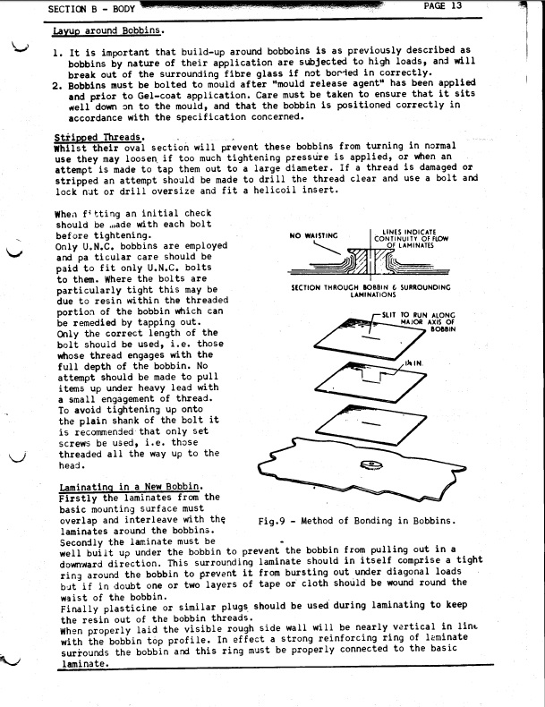

Here are a couple of pages on how to repair a torn out bobbin.

Good one Joe, I didn't know dem' pages were in the book.
