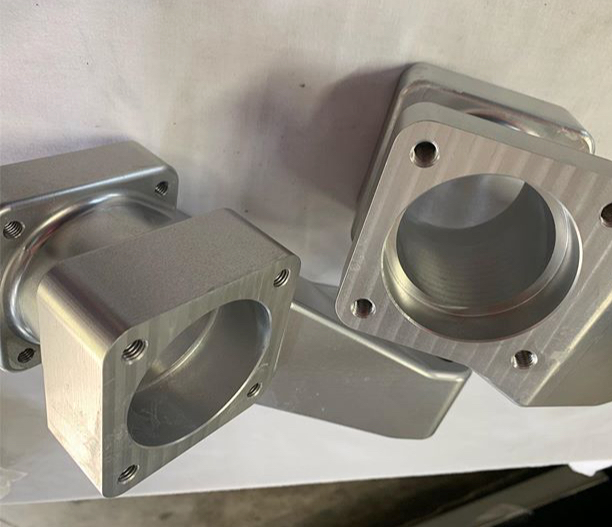

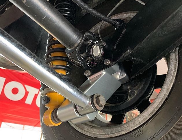

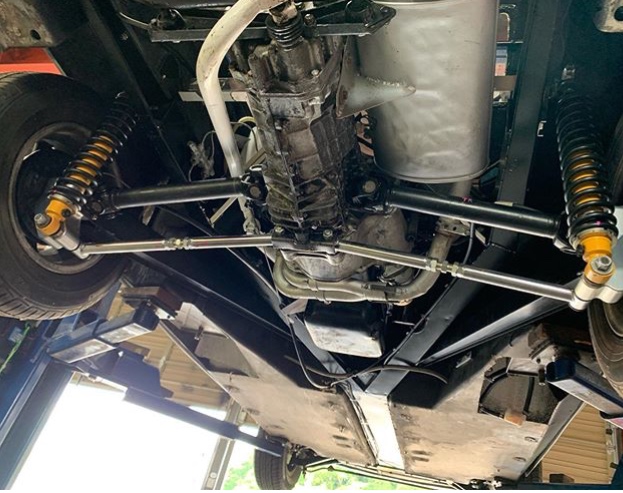

« Reply #21 on: Wednesday,May 22, 2019, 11:37:21 AM »
Found a few more pictures
  • Posts: 4,398
Re: New rear hub design .
« Reply #22 on: Wednesday,May 22, 2019, 11:47:18 AM »
Nice Joe , good find.
I sent out an instant message to topyard61 as to price and availability, however still no answer.

« Reply #29 on: Thursday,May 23, 2019, 08:28:02 AM »
Hi,
Sorry for the late contact!
I received a reply today and I passed it on completely below.
I also conveyed an invitation to our site and interests.
In the case of lotus europa sp rear upright,
 The production is requested to a company that produces Honda's formula one vehicle, prototypes of HRC such as Motogp, etc.
 The data of lotus europa sp genuine upright is generated by a three-dimensional measuring device, and after data correction, the material is A5052 and is cut by a 5-axis processing machine and finally finished by hard alumite.  .
 It is a price, but it will be 500000 yen (excluding tax) with the left and right set in Japanese yen.
Regards,
GARAGE TOPYARD,
