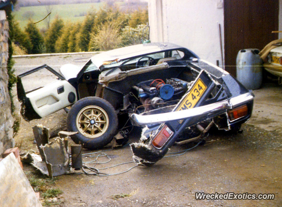

And this picture shows what could happen if a drive shaft fails while driving (found here http://www.wreckedexotics.com/accident/4269?c=mo450):
Mechanical failure of one of the drive shafts caused the driver to lose control in a corner and spin off causing severe rear damage.

Wow that’s catastrophic failure.  :blowup:
I will definitely take heed.
Re: How to check the rear stub axle for weakness?
« Reply #7 on: Sunday,February 24, 2019, 04:21:03 PM »
Yikes! That must have hurt!
