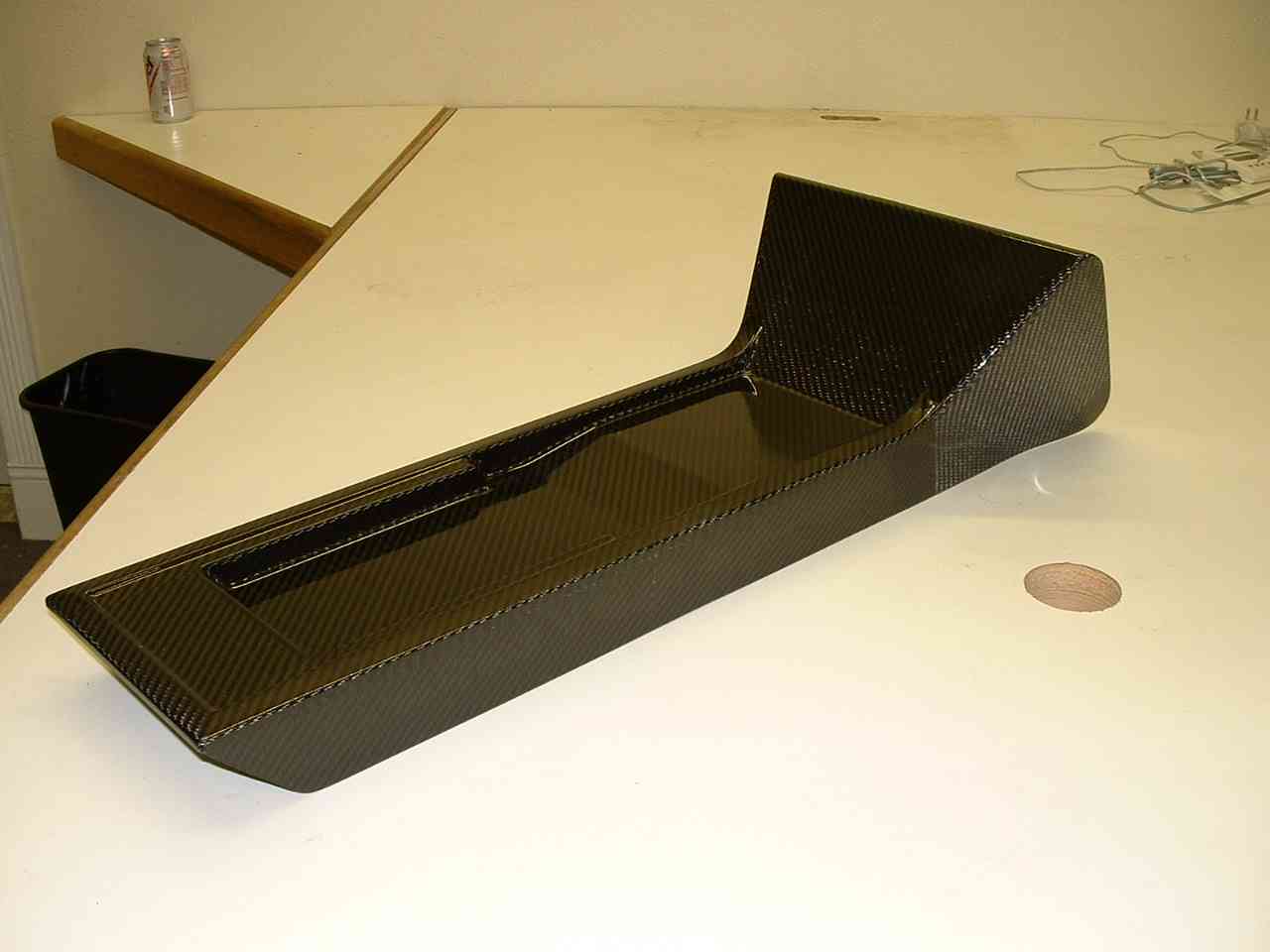

Maybe something like this?

Lotus Joe,
That console looks great! Is it made out of CF?

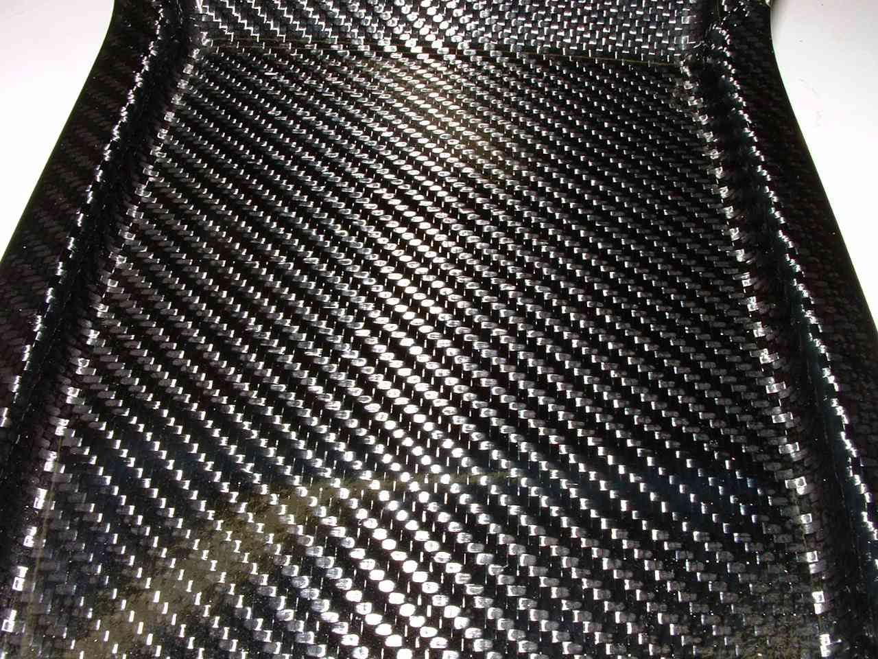

That's a very impressive lay-up Joe.
As the young folks say, "respect" to whoever did it, the way the matt plies are arranged is very neat. I'm not a fan of CF trim myself, but do appreciate good workmanship when I see it.
