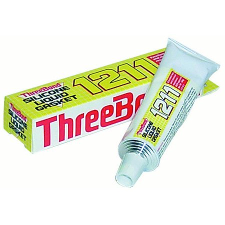

« Reply #7 on: Wednesday,March 28, 2018, 08:49:48 PM »
I have had excellent results with this product.

I have tried the 3 bond/yamabond/hondabond stuff...great on transmission halves where there are no gaskets....but on gaskets...well, then you have to break the gasket in half to get it apart.  I did it on a transmission, and had a really hard time getting the pieces apart without damaging anything (including the aluminum case).  So I wouldn't recommend it for gasket use.  I still use hylomar, since the gaskets will release and are often reusable.  I've also used 'the right stuff' and had good success, though that is for when you don't have a gasket and had one before....
