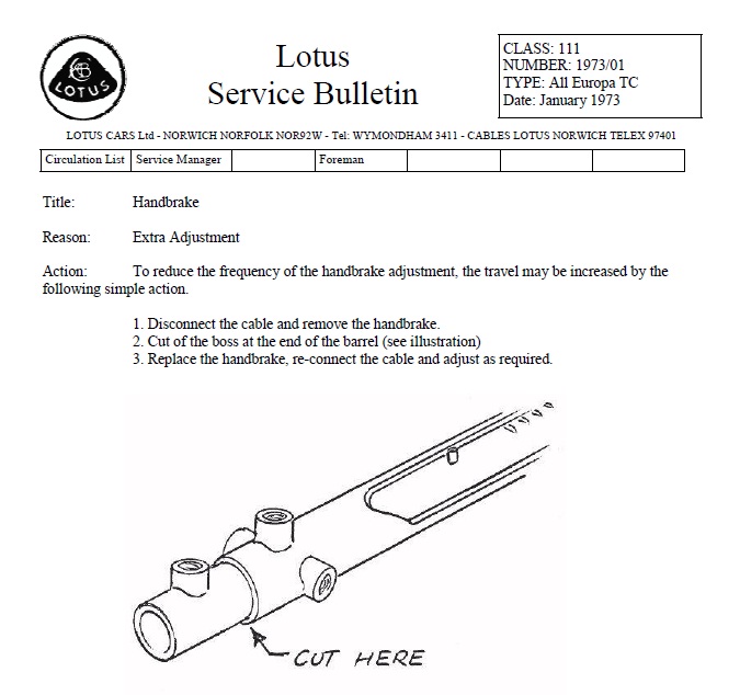

Re: TCS rear brakes onto a TC?
« Reply #13 on: Monday,December 03, 2012, 06:23:26 PM »
Gentleman, have you read your service bulletins?
Not the most elegant solution. But this will work.
