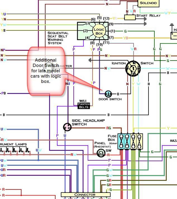

The additional hole on the driver's door jamb is for another door switch that goes to the logic box used on the Type 74.

Lotus Joe,
Are you referring to this question ‘“Certified, where on the jamb does the switch go ? See pictures dash/switch/wire run from aft forward?
   The dash mount bracket attaches to the far aft hole , that leaves one for the door switch and the other for the wiring harness for the power window motor and door speakers. I have an s2 fed.
    Are you saying type 74 have 4 holes in jamb? Or am I missing something?

That’s guys , Gideon correct on JB getting it correct. Made some mods and this is what I expect.
  • Posts: 10,199
Re: 1970 s2 0453R Reassembly
« Reply #400 on: Tuesday,October 23, 2018, 08:30:26 AM »
Amazing work, Dman! It sure looks like you're planning on adding new electrical components (did you already tell us about that?)!

 Guys , I was joking with the mod pic!
BDA is correct but I don’t know what the automotive people call it. It’s just black wrap.
Surf , I like permacel products,  P421 and others at https://www.e-aircraftsupply.com/aircraft_products/file/aircraft-products.aspx
Also http://www.firesleeveandtape.com/dms2186-mcdonnel-douglas-boeing-electrical-insulating-mil-spec-tape.html
 excellent tape that will bond to itself and stretches .
« Last Edit: Tuesday,October 23, 2018, 09:23:32 AM by dakazman »
  • Posts: 10,199
« Reply #404 on: Tuesday,October 23, 2018, 09:43:48 AM »
Quote
Well, I'm glad to hear that! Your picture was impressive but I thought somebody should remind you that white wires are hot with ignition on and unfused!  :)
