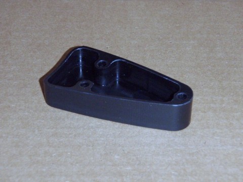

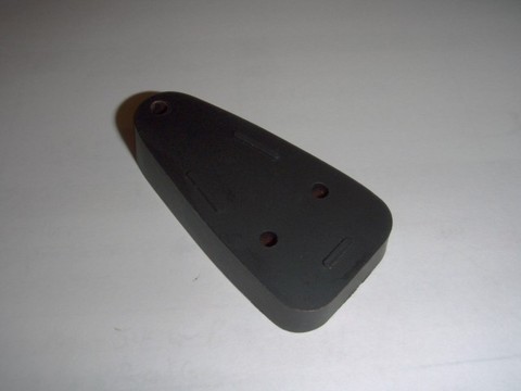

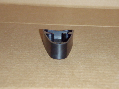

I haven't fitted them yet, but here's the "other" vacuum formed part that usually goes south:
I'll put the file on Thingiverse later on this afternoon.

« Reply #14 on: Wednesday,October 24, 2012, 10:26:58 AM »
I'd post the stl files of the parts I make, just in case someone can use them, but in order to do that, the forum would need to allow them  :help:
Until I can post stl files here, you can download this one at:
http://www.thingiverse.com/thing:33034
Enjoy.
I've added stl and pdf.
