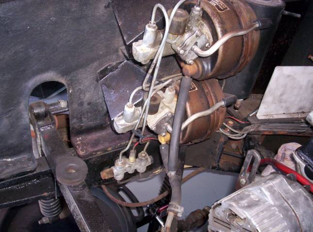

I thought we had Lockheed, mine look more like the Lockheed than the Girling. I can;t find decent pix of the boosters with Google, just this one which is nothing like mine
Here's a slight shot of mine:
« Last Edit: Friday,January 01, 2016, 05:34:43 PM by analogmike »
Regards, mike
'73 911RS, '08 911 GT3 cup, '01 Viper GTS, '74 Lotus Europa Special, '70 Lancia Fulvia 1600HF, '15 Audi S3, '04 TowRig
  • Posts: 10,205
Re: Dead brake boosters on my '74, rebuild?
« Reply #7 on: Friday,January 01, 2016, 05:49:00 PM »
Ok! The top picture has the stock Girling boosters. You have the Lockheed boosters like mine. Mine are probably 25 years old, but they have few miles on them, and they seem to be working fine so far. I'll have to print off those instructions for when I have to rebuild mine.
