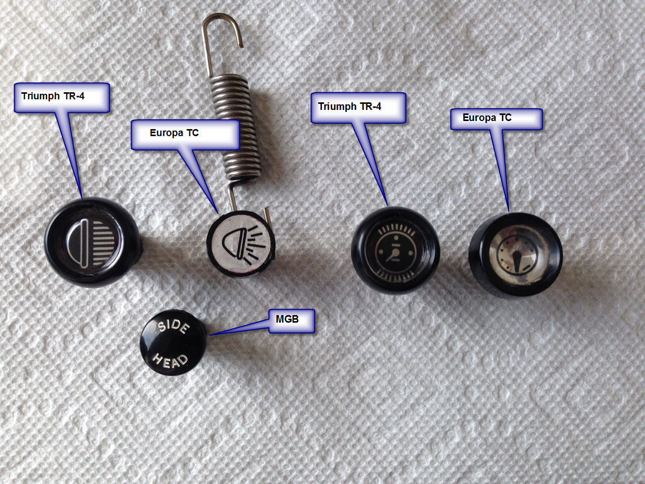

I have been looking for some time for a replacement knob for my broken headlight switch. I ended up buying one for a Triumph TR-4. Not the same as the originals, so I also bought the dash light dimmer knob as well so at least the two will match. They are readily avail from Moss motors and a reasonable price of $6.50 each. I also had one from an MGB, but as you can see it is very different from the others. At least the issue is solved until I can find that NOS knob some day in the future  :confused:

In my case the issue is both. My knob is broken and I have not been able to locate a replacement. I'm ok with the Triumph knobs even if they don't look exactly the same as original. That's why I replaced both so at least they would match. With the Triumph knobs it looks like I could change the logo on the front. I will have to have a closer look to see if the clear plastic pops out  :confused: . If I was able to change the center logos then they would look exactly as original, and that would be cool.
Please report back Joe. It would be great to be able to change the center logos. I'm afraid to try on my headlight knob as it is cracked but still marginally functional.

Thanks Andy. I'm OK with the Triumph knobs. I don't think anyone would even notice except maybe a concourse judge.  :beerchug: I think I would get busted with a Zetec engine in the engine bay long before they noticed the knobs.
