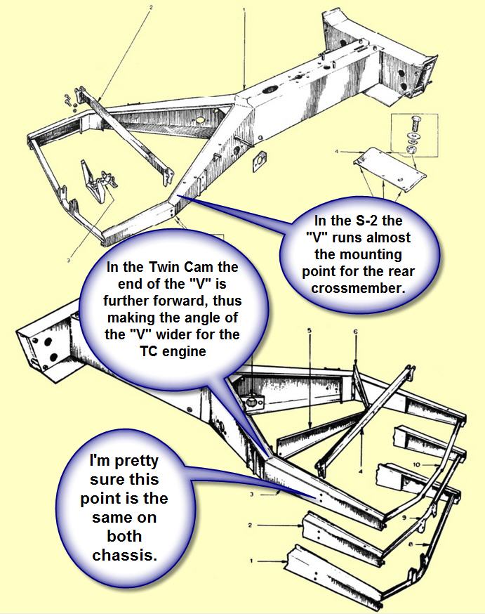

The Twin Cam can be put into the S-2 frame. However it will require modification to the frame; just the same as if you were doing a Zetec or Toyota swap. The S-2 frame is narrower than the Twin Cam frame. I don't have the exact measurements. The Twin Cam sits farther forward. But it can be done.

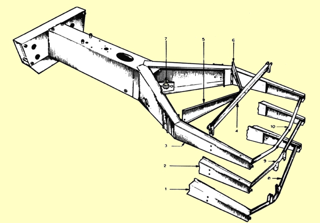

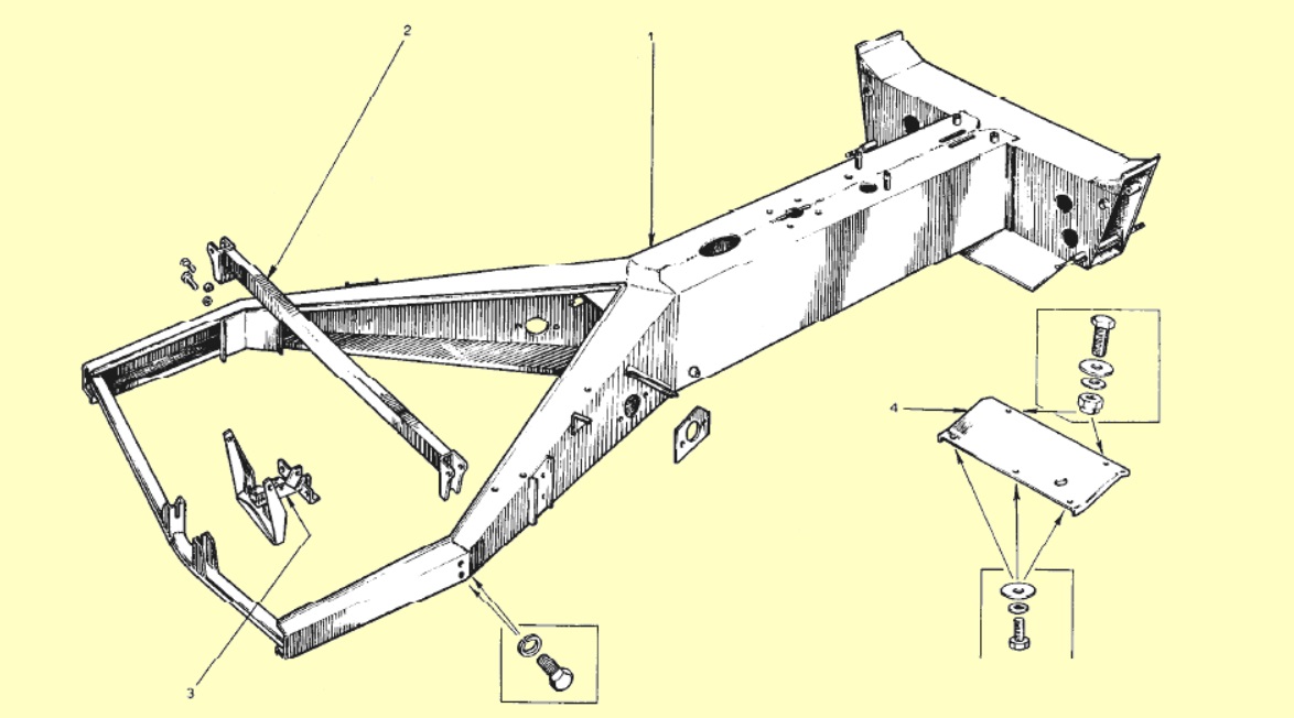

joe... the two drawings of chassis...presume they are s2 and twincam, but which is which? s2 at top?
looks like there are differences to suspension  maybe too?

The S2 frame is the top one.
Suspension is basically the same but there are different rear tranny mounts depending on the tranny used.

joe
thanks for the diagrams.....that helps a lot!!
