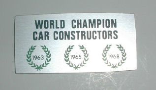

Was this a sticker or something that wore off or was there an emblem there that is missing?

I can't help with the rear damage, as a pure guess maybe someone has used a hydraulic jack in that area without spreading the load on the fibreglass and that's the problem ?   The last pictures is the world championship badge, a printed aluminium badge inside a chrome bezel. You might struggle to get the exact one, but you do see these things cropping up.

- world constructors badge: I believe that is what the fuzzy photo is showing. None of my S2s came with that badge.
  I believe only the TCs came with that one. See my photo

My '70 (0701R) had the ignition switch on the column like yours, but I moved it to the dash. My car also has the World Constructors badge. Electronic ignition was not standard - that looks like a more recent unit to me.

RD has your badge http://www.rdent.com/
