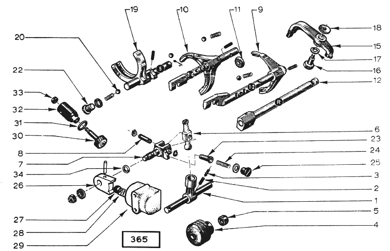

The Renault 365 transaxle came with 0.93 fifth gear and a 3.7x final drive.  The 336 transaxle had a 3.5x final drive.  A straight switch to the Renault 365 would have meant that the five speed Europa Special would have been slower than the four speed version.  So, Lotus had Hewland make up a special 0.85 fifth gear.  At the same time, also removed the fifth gear detent and came up with their external detent system.  Perhaps they were concerned the extra mass of the Europa shifting system would make the stock detent ineffective.  Regardless, the weird double-pivot, linkage was Renault, not Lotus.  Rear covers are the same.
What do you mean by the double-pivot linkage?
Do you mean the rods going from the gear lever, with the UJ by the exhaust manifold, and then attaching to the gear selector rods with a roll pin, or do you mean the spring loaded 1/2" ballbearing onto the indented plate/cam which prevents over rotation when selecting reverse and 5th gears?

So to jump on your thread. I fitted a new o ring to the double pivot selector assembly that the lotus dedent mech attaches to, it made no difference to the amount of oil coming out... so it must be worn... there is a fair amount of play in it.
Have you guys rebushed this area and stayed with the o ring, or fitted a seal similar to the sector shaft below it.... I hope that makes sense.....

You can see the double pivot in this parts diagram:
http://www.lotus-europa.com/manuals/tcparts/f/FL.gif
