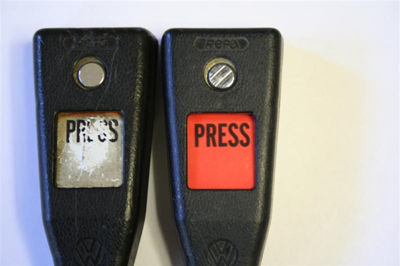

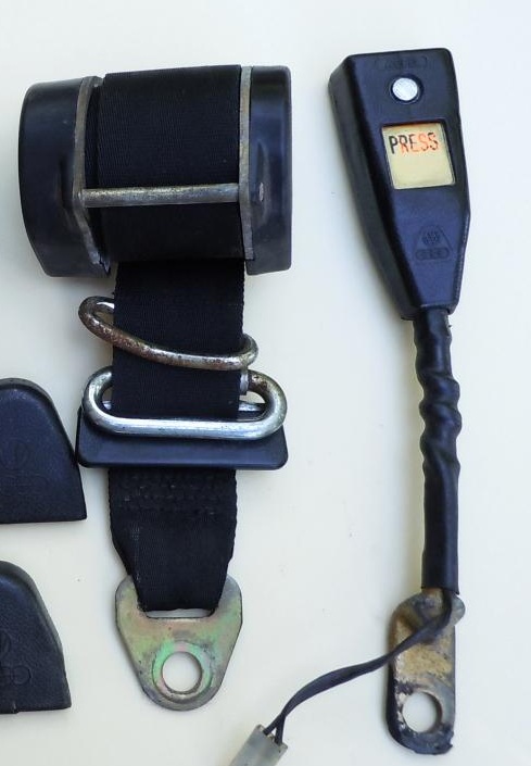

With regards to seatbelts, I think maybe ones from a Porsche 914 might fit.  :confused:

Those do look similar... But not the same ones. I emailed the guy I bought the seat belts from and he said he knows he has the buttons, he just can't find them in the boxes of parts he has. He also is dealing with some other projects at the moment right now too, so I'm being patient. I was just wondering if anyone had some laying around just to get my project finished even faster!

You think these stickers could be trimmed to fit?
« Last Edit: Friday,January 18, 2013, 12:43:41 AM by LotusJoe »

« Reply #58 on: Friday,January 18, 2013, 08:57:56 PM »
They might work, my dad said he might be able to make one out of aluminum and put a sticker on it. We will see later though. We will be doing a lot of work on the car tomorrow!  :)

I just bought some Kangol press stickers on ebay for $5, and hopefully they will be the right size. My dad said he will make the buttons out if aluminum than we will put the stickers on them if they are the right ones. Hope it works!
