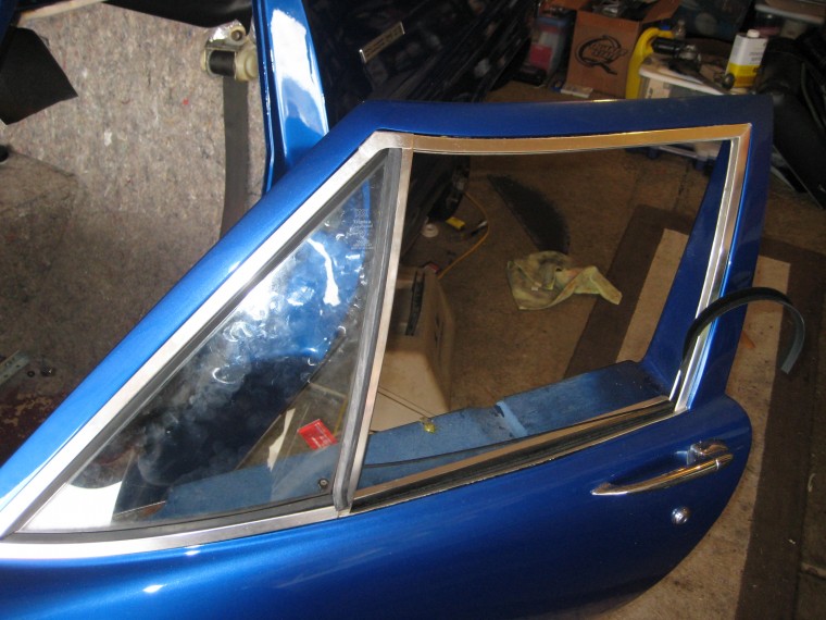

When you guys installed your door window trim did you use any glue? I noticed when I took mine out there was a black adhesive between the aluminum molding and the window frame.

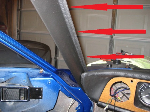

And did you add the vinyl molding around the wind screen?

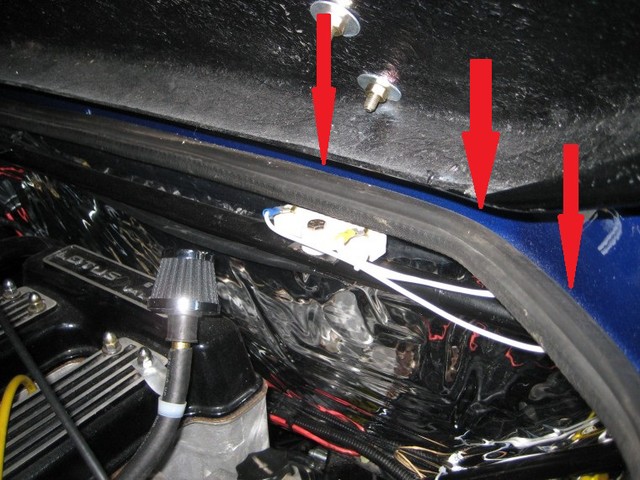

Also where did you get the rubber trim you put around the engine compartment and how is it finished down around the luggage compartment area?

LotusJoe,
1. We put a bead of black silicone under the window frame to seal it.
2. The windshield trim goes at the bottom of the windshield about 8 inches from the corners at the place where the fiberglass extends out towards the dash, up the side of the windshield, across the top, down the other side and along the windshield bottom like the other side. The crash pad went under the two sides where the trim is and we left some material along the front middle that went under the windshield itself that we trimmed to fit. We trimmed it around the vin plate also.
3. I had some of the old door gasket material that we cleaned up and used along the front engine cover area. It is very common material if you don't have any however.

Is the trim around the windscreen something you decided to add? I don't see it in the parts manual. Where did you get the chrome plastic surround for the windscreen?
