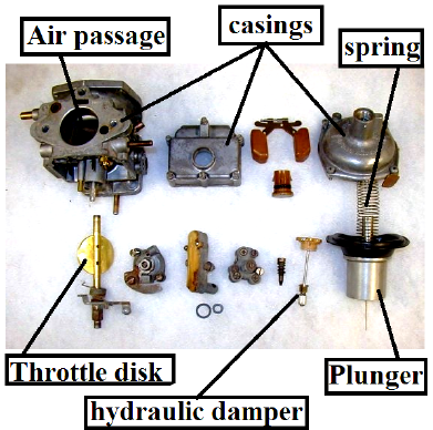

The needle in one of my slides seems to be spring loaded as it will pull slightly from the slide and then go back in, you can also twist it freely in the slide. My other slide the needle doesn't seem to be spring loaded and you can't twist it with your fingers. Which one is correct? How do you get the needle out of the slide? I would rather ask than mess something up....

If you haven't found it, yet, the Buckeye Triumph site has a fantastic series of pages on the Strombergs.  The snippet below from that should help with your specific question, but worth a read.  I rebuilt a set for my Elan a couple years ago and have several spare bits so can grab pictures of anything "internal" should you need.  Also, the burlens site is quite valuable.

The Stromberg needle comes in a holder (as shown in SENC's photo).  If it is a fixed needle, then there is a screw on the side that holds it in place.  The needle holder has a corresponding flat spot for the retaining screw to bear upon.  If it is an adjustable needle, it's a bit more complicated.  The screw on the side is a guide pin that fits in a slot cut in the holder.  In order to remove the needle, you first use a special tool down the damper tube and turn the adjuster until the holder sticks out the bottom. Now remove the guide screw, hold the needle holder and turn the adjuster until the needle holder is free.
Lotus TCs never came with adjustable needles but it is a better way to go.  You can get the pistons for adjustable needles from a TR6 or TR7.  Then order replacement UK spec needles and swap them into the adjustable needle holders.  I would also change the needle jets at the same time.
More info here:
http://www.lotuseuropa.org/LotusForum/index.php?topic=3619.msg37946#msg37946
