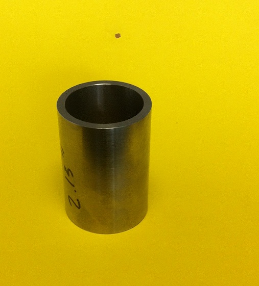

The inside of the upright is hollow as I'm sure most of you know. I suspect this was a product of the casting process. My thought would be to leave the upright solid with a hole slightly bigger than the stub axle to eliminate the need for the steel spacer. Taking Trevor's idea a step further, maybe pressing in a steel spacer on the inner bore and a steel sleeve for the outer bore. This would make the landing for the back side of the bearings larger and help eliminate movement in the upright. I also like the addition of the circlips.  An update on the bearings I think would be in order. I'm not an expert on what that would be, so more research is needed. I am thinking of having them made in 6061 aluminum which would be far superior to the aluminum cast. Being able to accommodate all the models would help eliminate the need for multiple designs. But it would have to be done in such a way that didn't require a bunch of additional modifications to any of the ancillary parts. It looks to me that the main difference, aside from the bearings is the attachment of the lower link. The S-2s lower link looks to be offset so it can attach to the upright on the same side as the shock, where the TC Special is straight and attaches to the opposite side. That may be a simple as boring both attachment holes. I haven't measured the different uprights so I'm not sure if it is that simple.

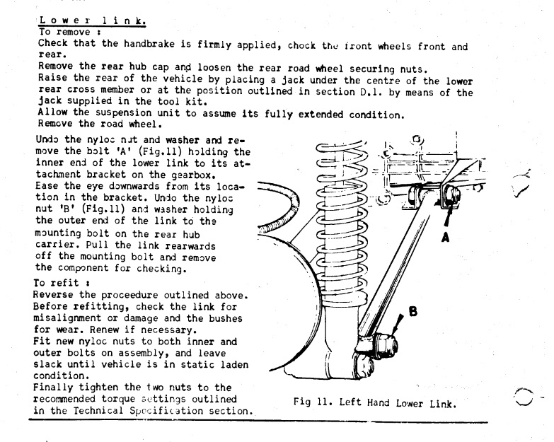

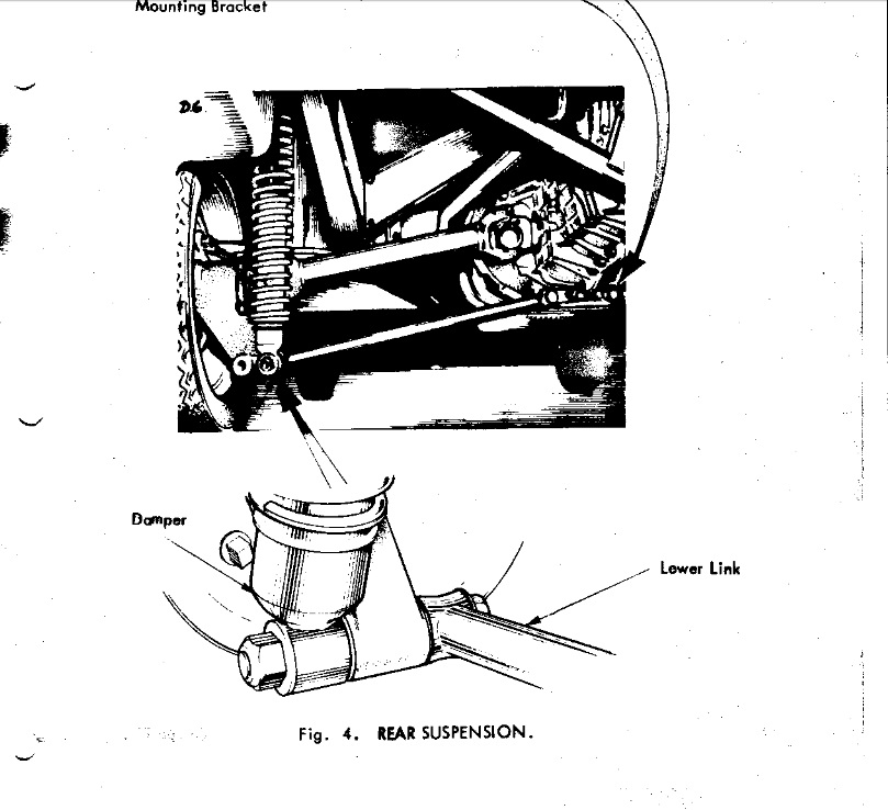

I think your interpretation of the lower link/damper assembly is right, the casting looks (from pictures at least) to be able to work with both designs.
A solid casting would be quite a bit heavier and might raise another problem with the potential for shrinkage cavities inside the section; there are lots of ways to combat this and of course you can make much thicker Al castings, but it will complicate the casting procedure. So maybe there might have been good reasons for having a hollow casting ?
But you could still have a thicker bearing section with a built-in spacer and personally I think it's very possible to come up with a design to appeal to the S2 & TC owners.  The snag in my mind is exactly what loads you get from having the driveshaft as the upper link, if it wasn't there it would be much easier.  The Elise for instance uses a thick Aluminium extrusion as a carrier - yep, they just squirt out a length of extrusion and slice it up into hub carriers ! ( ok, maybe it's not quite that simple....   ;)    )

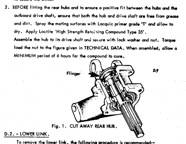

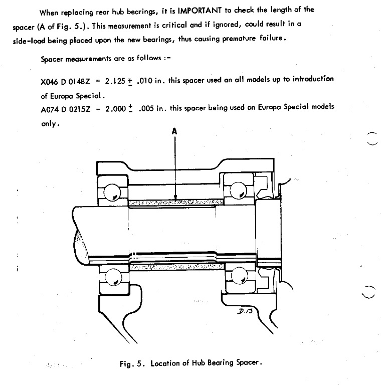

I'm afraid this would not work since the bearing inner races would then jam on the upright and lock the stub axle to the upright. Remember that the original design locks the stub axle, the inner bearings inner race, the steel spacer, the outer bearings inner race and the hub flange firmly together. And then the outer bearings outer race is held in place in the upright by the square plate on the front link arm. While the inner bearings outer race is free to float in the upright and letting the balls roll freely in both bearings. I don't have the link ready, but the workshop manual has a very clear drawing of this.
But I really like the ideas you posted of steel inserts for the bearings or the idea of using some better material than originally. I have a Special, and had no problems sourcing the bearings, so making a uniform upright with these bearings would be an improvement for S1-2 and TC. I don't know enough about bearings to come up with yet another type that would beat the Special's configuration.
As I see the original design, it looks like someone took the smallest possible diameter to hold the bearings and then added the 'ears' for the front link arm and the 'hanging part' for the lower link. In my view a new upright might as well be square on the outside from the start, and maybe the part for the lower link could be a second part that attaches to the center part. And the part for an optional upper link could as well.
I found the drawings and put them in my previous post. I get what your saying...More thinking required  :confused:

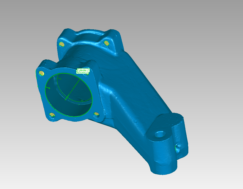

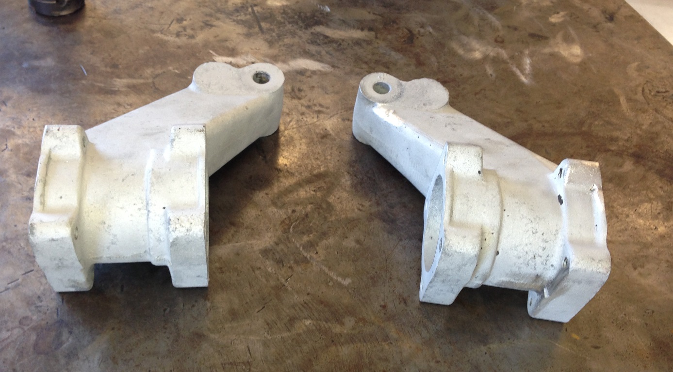

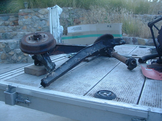

I got a pair of uprights from one of our members (Joji AKA Grumblebuns) they were however still assembled in the trailing arms. But with a little persuasion I was able to get them apart and cleaned up good enough to scan. More progress next week. If anyone is looking a set of slightly bent trailing arms he might want to sell them.  ;D

I thinking about solid 6061 Aluminum. I filled the void with water and it was just over a cup. So if you do the conversion it should be somewhere around 1.4 lbs of additional weight per upright. Too much?  :confused:

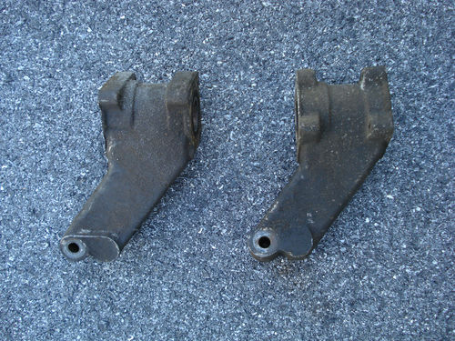

Completed the Upright scan today!
I also weighed the stock carrier and it is 2.4 lbs.
« Last Edit: Monday,July 01, 2013, 04:32:10 PM by LotusJoe »
