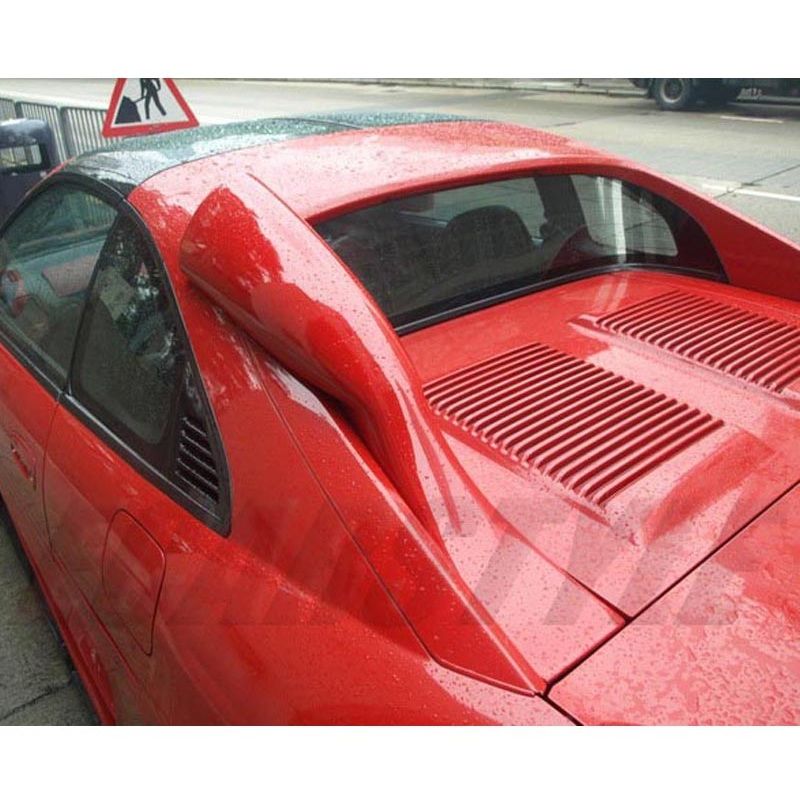

Some inspiration:

« Reply #364 on: Monday,February 15, 2021, 09:43:50 PM »
Love the pictures. With the way the Europa trunk opens any ideas on how to make a quick disconnect?
Re: 70 S2 0044Q
« Reply #365 on: Tuesday,February 16, 2021, 06:36:05 AM »
Normal vent screen out, foam seal for paint protection, moulded in "hooks" at the rear and a padded hook on a thumbscrew at the front.

« Reply #368 on: Friday,March 05, 2021, 09:05:40 AM »
Restyled air scoop. All suggestions welcome.

« Reply #369 on: Friday,March 05, 2021, 09:08:00 AM »
This style allows the Rear deck to be lifted with out removing scoop.

« Reply #370 on: Friday,March 05, 2021, 10:03:08 AM »
Being able to lift the rear deck sounds like a good, practical attribute.  I know I'd be more tempted to try something like this if I didn't have to remove it every time I opened the engine cover.  It also gives you more options for the fixing hardware and the chance to hide most of it under the deck.  I wonder if a taller, narrower "mouth" wouldn't provide better flow into the "neck" of the air scoop, but I'm probably just picking nits.  I think it looks promising.

« Reply #372 on: Friday,March 05, 2021, 11:13:19 AM »
Thanks JB. Gideon, I am trying to mimic the look of the front grill to give it a "period correct" look. If you look at the air flow over the roof (Look up Wind Tunnel test) it stays very close to the roof. The next job is to design the under side attachment and deflector to bathe the carb. air cleaner in cool air. I will also flair the bottom edge so I can add foam to protect the paint.
