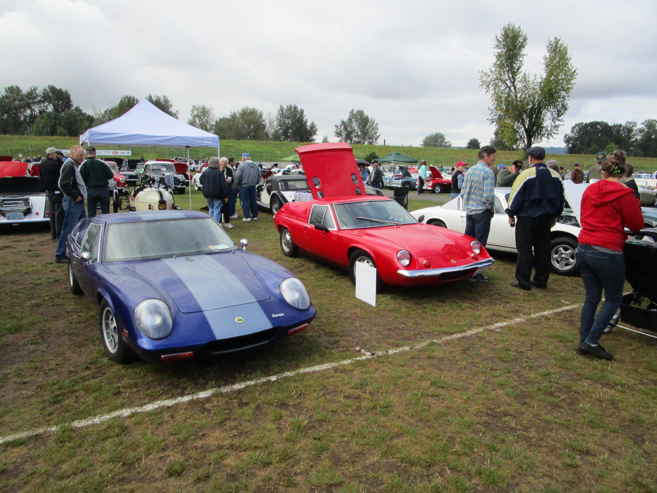

Yes the windscreen can be mounted directly to the fiberglass flange without the original trim. I have seen 2 examples, an S2 and a TC, with simple black vinyl trim covering the gap. Sorry no pictures.

Did find a photo of the S2 with black vinyl windscreen trim:
http://www.clnw.org/wordpress/wp-content/lg-gallery/2016/2016%20ABFM/IMG_0785.JPG
  • Posts: 10,208
Re: TCS Windshield Surround Alternative
« Reply #22 on: Tuesday,May 01, 2018, 03:35:42 PM »
Thanks again, Swift!
