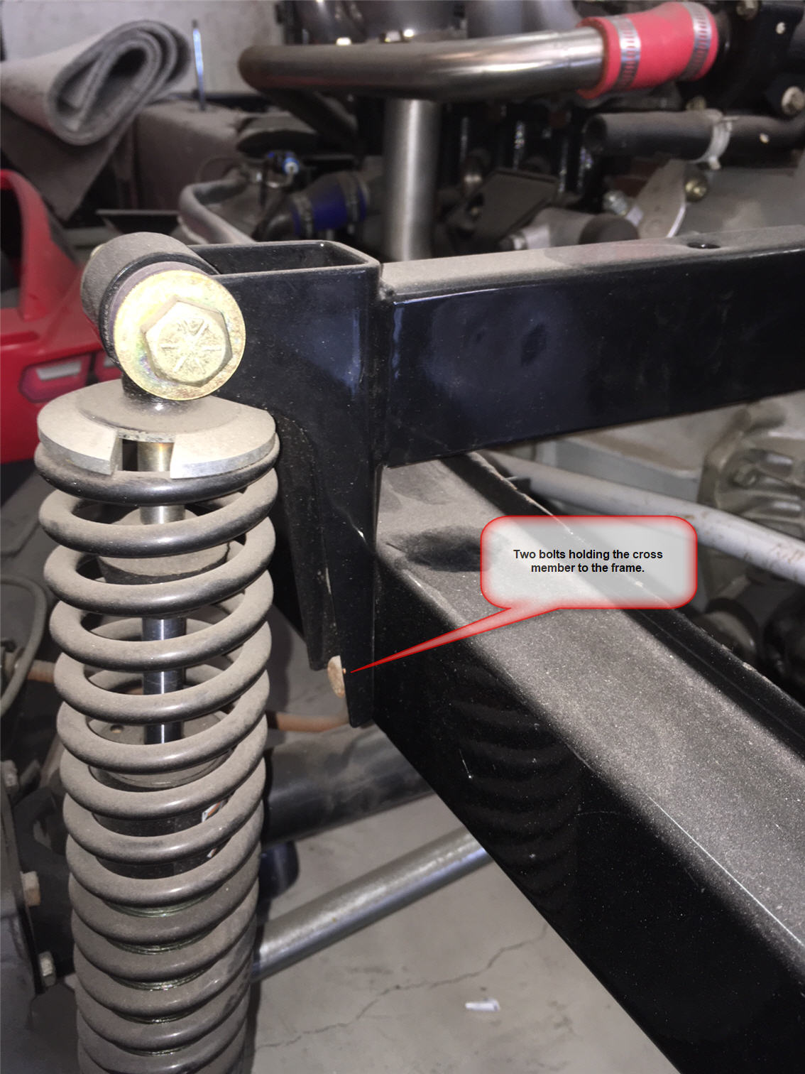

A question that could be answered easily if I was next to the Europa.I have to bolt the "cross piece" of the frame to the main frame and go through both sides of the main frame.
What is the dimension (approx) between the two arrows I have drawn?
I know the originals just go through one side but this frame was boxed in(added strength) which limited my access to those bolts.
Like I have mentioned this Europa is in my Father-in-laws drive shed an hour and a half away so I need to go there with the proper lengths bolts in hand.
Thanks
Bernie

The bolts for the cross member don't go though the entire box section of the frame. They only go through the "ears" of the cross member and the first sheet of steel on the back "legs of the frame so your bolts will only be gripping about 1/4".
That assumes that you're not making a modification that requires you to go through the while "box" of the frame.

HI:
You are correct but the frame "boxing" went down to a point where I can't access the nut(s) on the inside of the channel as it is now inaccessible.
The pic I used is not of my machine but there to give reference as to how long the replacement bolts need to be.
If I had to guess it would be in the area of 2 to 2.5 inches?
Thanks
Bernie
  • Posts: 10,231
Re: Frame Question
« Reply #3 on: Monday,June 11, 2018, 04:21:22 PM »
I make it more like 1 3/4" but that is probably only to +/- 1/4" since on my car, there is a lot of stuff in the way of making a really accurate measurement.

G’day Bernie,
There are no "nuts" inside the chassis leg.
The stock bolts screw into a welded-in and threaded thick steel section.
25mm bolts would be fine for this.
The measurement between your black arrows is ~ 60mm.

I made a new one recently and my (TC) chassis looks very similar to yours. No access required to the internal box section, they go into a steel plate.  I'd guess Gavin isn't far off on 1" bolts either, they're certainly not very long.

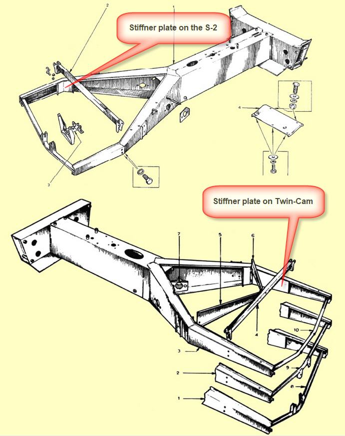

I think his chassis has had an additional plate added across the 'open' side of the channel - he says in the original post that the chassis has been 'Boxed in'  - which is why he is asking for the dimension marked in his pic as he can't fit the standard length bolts because they won't make it through the other plate?
If the chassis has been 'boxed in' then for added strength it is worth fixing some sort of spacer tubes between the two faces of the chassis to prevent any 'crushing' of the chassis as the bolts are tightened etc...

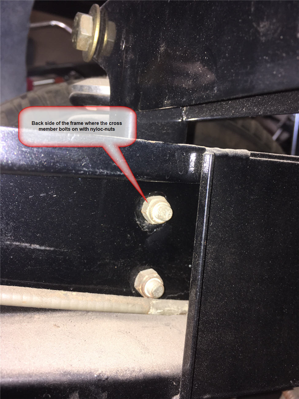

HI Lotus Joe:If I had access to the Nylocs I would'nt have my problem.
The boxing of the frame hides and goes far enough back to not allow me to get at them.
Now my question is :are the cross member securing bolts held in place with Nylocs or are the stock bolts screwed into a welded-in?
Does this change with the year?
Bernie

The boxing of my frame stops just short of the nuts. So for me they are easy to get to. Not sure about other years. Mine is a TC Special '73. I looked at the parts book for the S-2 and it looks to be covered, but you still should be able to get a spanner in there to hold the nut on the back side.
« Last Edit: Tuesday,June 12, 2018, 03:51:06 PM by LotusJoe »
Re: Frame Question
« Reply #14 on: Tuesday,June 12, 2018, 03:55:28 PM »
I just re-read your post and now realize that your frame has been modified by closing the back side of the frame. Hopefully they thought ahead and did in fact weld some nuts to the frame.
