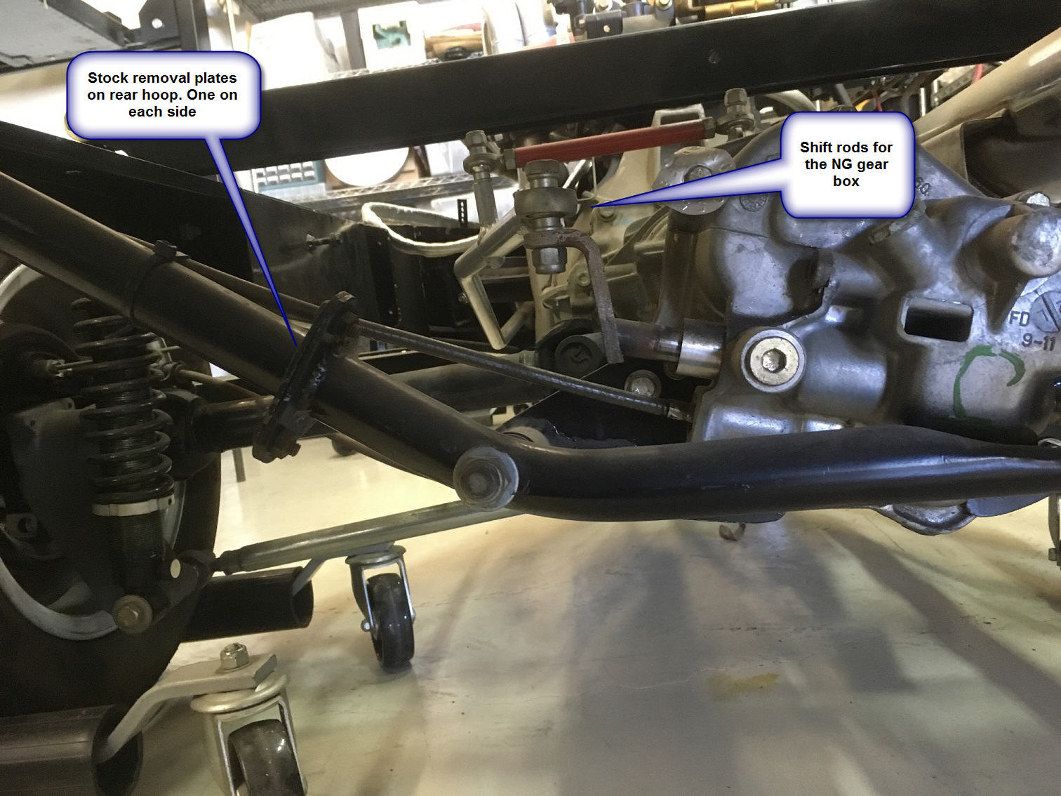

Are you using the Banks shift linkage kit? Is there a chance your solution is going to impinge on your shift rods? I have the same NG conversion using both the Banks rear hoop kit and the shift linkage kit.
This was my solution to the same problem

« Reply #59 on: Monday,March 13, 2017, 05:09:17 PM »
Joe,
Thanks for the input.
I really like how you made the center section of the hoop removable, that's nice!.
Banks doesn't do the shift kit any more it seems, at least when I purchased the NG3. I was opting out for a cable shift system anyhows. I'm probably going to copy D. Anderson's method of attaching shifter cables to the rear cover shifter shaft.
After posting the above photos, and BDA's comment about using the shock mount crossbar as a mounting point for the transaxle, I'm looking at that. It appears doable.
