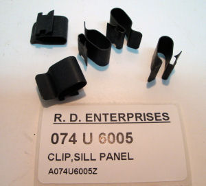

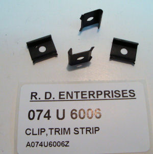

The silver sill panel is held on with pop rivets in the front and rear wheel arches, and double sided sticky tape, on all the ones I have removed. The chrome strip is held on by about 6 metal clips which are secured to the fibreglass and the strip just spring clips on to these metal clips, which go rusty.
Alex in Norfolk.
Chrome Trim Clips (18 per car)
Valance clips used along the bottom
