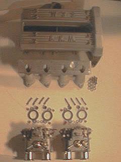

Well BDA, ya got me curious.....  and I reckon you're right.  These look familiar ?   :)
The captions on those photos look the wrong way around to me.
