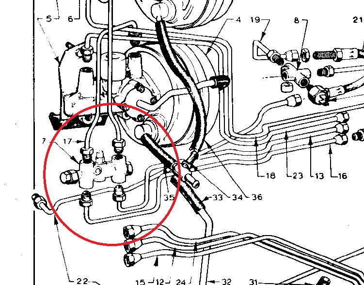

Thanks for the info Brian. Very interesting. Did your car have a remote reservoir from new? The reservoir on my car is not remote, though the m/c is mounted so low in the car that it almost seems as though it is no higher than the calipers. I am planning some improvements to my braking system, including  redoing all of the brake lines to get rid of the mess in the engine compartment. The boosters have been removed from my car by the original owner, but the brake lines are a mess as a result. Fluid for the front brakes goes all the way to the rear to the 'brake fail' switch and boosters (when they were there), then forward to the calipers. My plan is to get rid of all this mess and mount the fail switch up front near the master cylinder. I may consider fitting a remote reservoir at that time to make brake service more convenient. The m/c is so low that I can't see how it works, and will be even worse when I fit the 1" lowered springs on the front.

I haven't installed a fail switch circuit. Yes, I know, only doing half a job......    But seriously I don't see why it's needed if you install a brake fluid warning system, which is the next part of the change, it just seems to complicate matters to me. I don't really need to know if the front or rear circuit has failed, a drop in fluid level is enough to panic me anyway !
I wonder if the m/c mounted reservoir is a federal thing.
The 'fail switch' is an integral part of the dual circuit brake system. The 'switch' (poor terminology, my bad) is a shuttle valve that isolates the failed part of of the system. In the event of a failure in one of the brake circuits, the shuttle moves within its housing blocking off the part of the brake system that has 'opened', thereby preventing further fluid loss and preserving the integrity of the remainder of the circuit. Of course, it also incorporates an electrical switch to illuminate the brake warning lamp on the dash.
I guess the problem with not incorporating this unit in the system would be uncontrolled fluid loss in the event of a system rupture. All of the fluid in the reservoir would be lost.

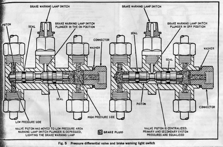

to help add to the confusion I found this explanation on the Pantera site.  :beerchug:
http://www.panteraplace.com/page89.htm
I also found a picture of a shuttle valve.
Looks pretty close to the one used in our car.
Nice find, Joe, and it does indeed look similar to the units found on our cars. Looking carefully at the illustration, it does not support my suggestion of circuit isolation in the event of a line rupture. My explanation above is an attempt to pull a distant recollection from my auto shop days at trade school. I have just done a little quick online research and can find no evidence to suggest circuit isolation is a function of this valve. It appears to be merely a warning switch. All this time I've had the function of this component wrong.   :-[ Apologies all around for spreading false information, and especially to you, Brian.

Your comments made me sit back and think about the set-up and before Joe posted the schematic I did wonder if the valve shut down one circuit completely how you were meant to bleed the brakes. But I've never seen inside one of those valves so had no idea.   I couldn't work it out and so decided that when my new tandem reservoir arrives with it's low level fluid gizmo, I'd open up one circuit and keep pressing the pedal to lose all that circuit's fluid and see if the other circuit would still apply the brakes.
Very crude, very simple and exactly the sort of experiment I can relate to....  :)
