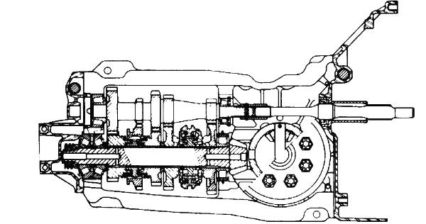

There are hypoid final drives and there are hypoid final drives.  Many US solid axle diffs had their pinion gear so low it was practically falling out the bottom.  The stress on the diff gears was enormous and they even chewed up special oils in short order.  Some transaxles also have a the pinion gear offset from the ring gears centre line by quite a bit and the use of hypoid gear oils is VERY important.  It is also true that the Renault transaxles use hypoid final drive gears.  However, all that said, the pinion is only very slightly offset from the ring gear's centre line so any increase in stress between the gears is minimal.  Finally, people have been using the non-hypoid gear oils in the Renault transaxles for decades with no problem.
Here is cross section of a 336 transaxle showing how the pinion aligns with the ring gear:
http://www.lotus-europa.com/manuals/s2work/f/big/fig4.jpg

As a comparison, here are two cross sections of typical hypoid diffs:
http://machinedesign.com/site-files/machinedesign.com/files/uploads/2015/04/Hypoid%20Gear_2_0.jpg
https://upload.wikimedia.org/wikipedia/commons/d/d1/Sprocket35b.jpg
As you can easily imagine, the increase in stress is enormous as the teeth "wipe" across each other.
