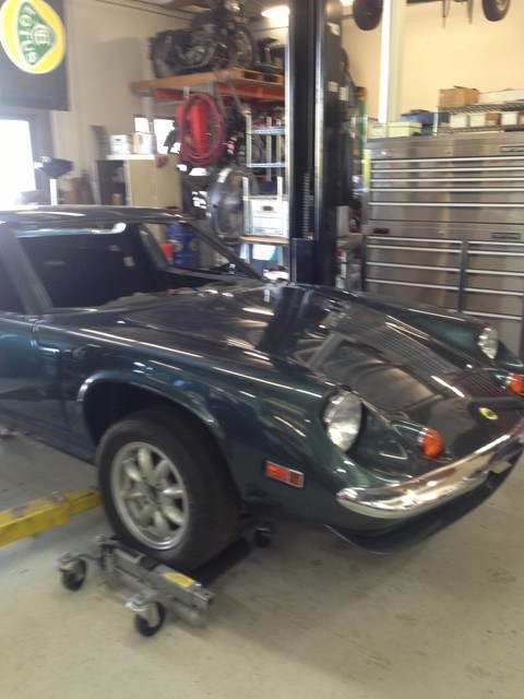

I used Duratec Surfacing Primer when I had my car painted. Paint is about 10 to 12 years old. Still holding up very well. My car was striped down to the gel coat and beyond in places.
http://www.fibreglast.com/product/Duratec_Gray_Surfacing_Primer_1041/Duratec?gclid=COry257UhskCFY-VfgodACwH9w
Sorry for the crappy picture
