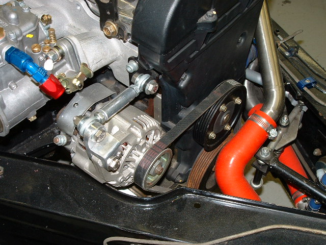

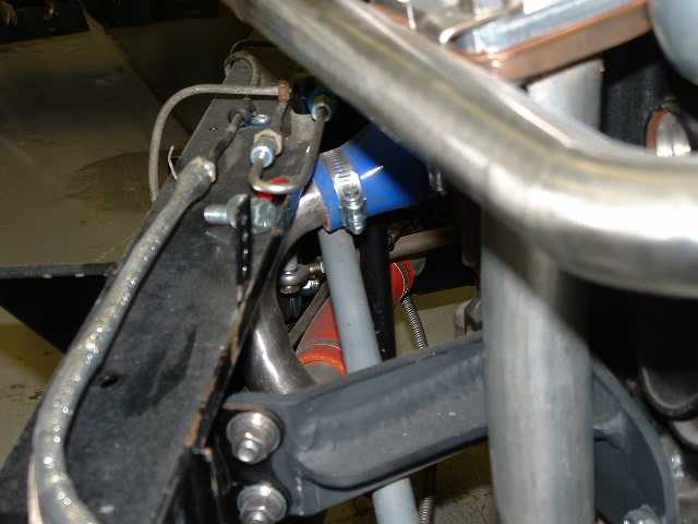

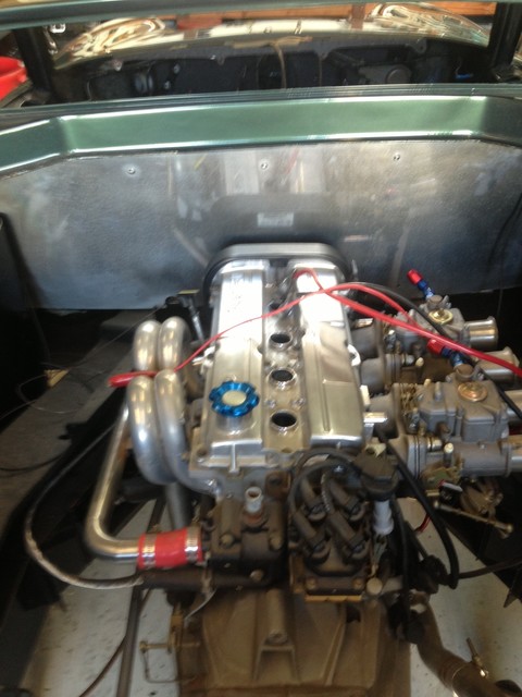

I have posted numerous photos of my Zetec conversion in this yahoo album.
https://groups.yahoo.com/neo/groups/LOTUSEUROPA/photos/albums/517570500
You should be able to find a few photos of the engine brackets.  At the end of the day, you will need to fabricate mounts.

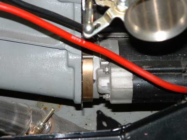

Also, since you are starting with an automatic the Zetec starter will have to be switched out for a Zetec manual trans starter.  Hard to believe, but they are slightly different and not interchangeable.  Photos of the differences are in the album.
Yes you can use the twincam bell housing, but I had to fabricate a bracket to mount the starter and then I cut a hole in the bellhousing to clear the starter nose.  It seems to be working out fine five years on.
I have a full set of wiring diagrams for the MejaJolt installation, (which is straight forward) available here.  It is a pdf file.
https://groups.yahoo.com/neo/groups/LOTUSEUROPA/files/Zetec%20Megajolt%20S2%20Manual/
I also had to modify the input shaft bearing holder, but I am using a 336 box.  If it is the same, you can find the specs and photos in the referenced .pdf doc.
Pay attention to the waterpump.  On the S2, I had to change the outlet to clear the frame rail.  Also getting the water routed and bypassed correctly is tricky.  I documented the routing in the manual, so follow that closely or the car will stay hot, or stay too cool.
When you get close I can send you my MegaJolt ECU ignition map.  It should be a good starting point for your tune.
Fun fun!
Dean

The series 2 Zetec will bolt directly to the Renault based bell housing. Here is a link for the different Zetec engines.
http://www.lotuseuropa.org/LotusForum/index.php?topic=91.0
If you use the Series 2 engine I have a jig to make the motor mounts.
Richard at Banks helped me spec out my Zetec. We used a stock Zetec flywheel and pressure plate with a modified clutch plate to accommodate the Renault input shaft splines. I used the stock starter with an eleven tooth starter gear and spaced it away from the flywheel.
If you are using an engine from an automatic then besides having to change the flywheel you will also have to change the pickup sensor for the timing. Stock item at any Ford dealer, IIRC it was like $25.00.
Dunnell Engines in the UK are the goto guys for Zetec modifications. Paul Dunnell is very easy to work with.
http://www.dunnellengines.com/zetec.php
I also changed the water pump to rotate the proper direction. (Sourced from Dunnell)
I would say if you pick the right Series of Zetec the conversion is pretty straight forward.
The engine placement for the Zetec works out to be pretty close to the stock Twin Cam. There is plenty of clearance.
