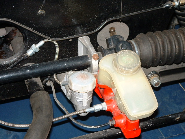

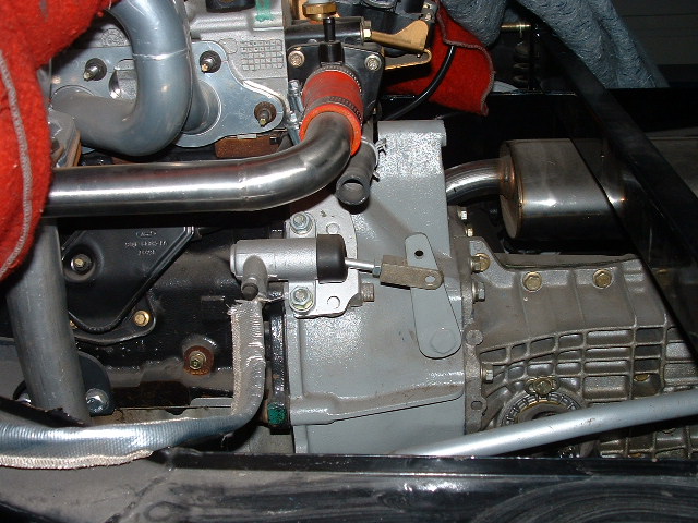

OK, here's some pictures.

Very nice modification  :trophy:
I converted to hydraulics, but only the leaver.

Nice install.  When I first put in the Quarter Master clutch I had considered using a slave ram like yours but had some clearance issues to mount it between the shift linkage and headers.  When the clutch fork eventually broke I figured the hydraulic bearing was my only avenue.  I ended up using the shortest one Tilton makes and a 1/2" mounting plate, and the clutch/bearing clearance worked out perfectly.  I also had challenges mounting the master seeing I already have a dual master brake set up with interior adjustable balance bar.
