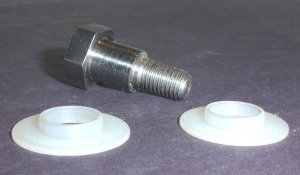

There is a two piece bushing where the gear shift lever is attached to the link.  Also, the gear shift lever bearing could be worn.  The photo is from RD enterprises.
Re: Gear linkage issues
« Reply #3 on: Friday,January 04, 2019, 04:22:06 PM »
Bushing repair kit from RD Enterprises
