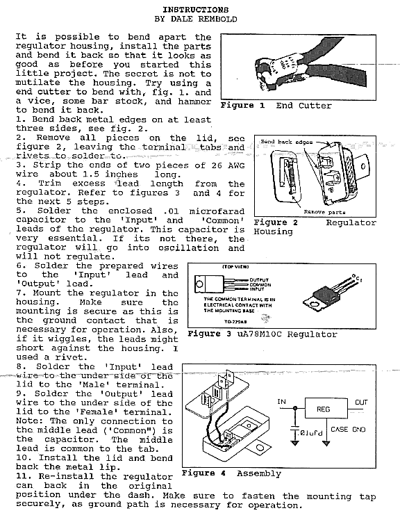

The original voltage stabiliser is a very crude electro-mechanical device. You will see what I mean when you open it. It is supposed to maintain an average of about 10 volts. I have replaced it with a solid state 10 volt regulator that should last for ever and be 100% stable as well. See attached.

I thought I would add to the thread here.  Found this a while back and plan on this mod on my TC in the future.
http://www.lotus-europa.com/manuals/misc/electrical/vregulator.gif
Of particular interest if going with this mod is note 5. i.e adding a .01ufd cap to prevent oscillation...
  • Posts: 1,580
Re: Voltage Stabilizer location
« Reply #12 on: Sunday,January 22, 2017, 07:27:59 AM »
I built my own voltage stabilizer many years ago, possibly using those instructions. Although it work as designed, I found that trying to fit all of the components in the original box without shorting something out was impossible and left the circuit just hanging behind the dash. Eventually I bought a ready made VS from a vender for $20 to replace my home made VS. You may have better circuit building skills than I did.
