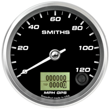

4380r, you put a Speedhut Speedo in your car. What size did you buy?

Hey, Joe,
I think I remember 4380r sold his car. If you get the Speedhut GPS speedo, you want the 3 3/8". It's a little too big so you have to do a little trimming on the instrument binnacle, but from the picture he posted, you can make it work. Smiths also sells an electronic speedo that you can use a GPS antenna for input. It's closer to the original gauges and of course can he had in the standard 80mm size. I have one and I really like it. I think it might be a little more expensive, but for me it was worth it because I didn't have to take the risk of buggering up my binnacle and it is a better match.. You can get them here: gaugeguys.com. The GPS antenna is on the accessories page (http://www.gaugeguys.com/accessories.html). Oh, the speedos come with a half-V bezel, but the can fit a half round one so it's more like the original gauges.
