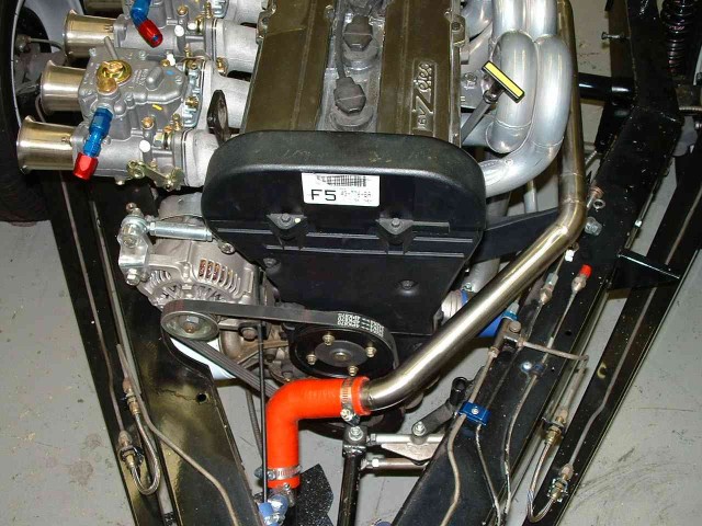

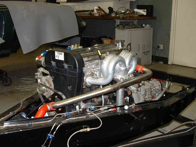

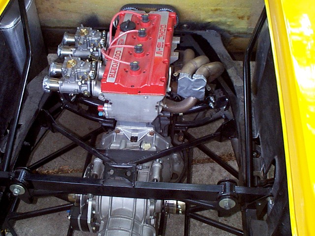

Since your a Ford guy I would recommend the later models, twin cam  or twin cam special. Both use the Lotus twin cam engine. Or you could always replace the engine with the Ford Zetec engine. That's what I did, replaced the Lotus twin cam with the Ford twin cam at a fraction of the cost for the engine. More horse power, less leaks. There is a lot of information on the cars.
Or the Cosworth works nicely as well

Thanks so much for the responses so far. Please, keep them coming.  Couple more questions - I'm sort of leaning toward the S2.  I actually like the bread van look of the original body and the ability to simply unbolt the body from the frame. Of course, that would preclude me from using a twin cam and still be "correct."  Since I'm allergic to Renault and the idea of the added horsepower does appeal to me - 1) Would the addition of the twin cam motor enhance or detract from the car's value? 2) Is there a decent source for Ztecs or are they difficult to hunt down?  and 3) Once located, are they a bolt in deal or is fabrication required?

John can tell you more about the Ztec, but from my standpoint, it is a nice alternative. You can get a Ztec crate motor and their not that expensive. It will require changes to the frame and the way it mounts, the mount to the bell housing, as well as grafting in the modern electronics into the original wiring loom unless you make a new wiring harness. You can get away from a lot of the electrical work if you use carbs like Webers, but that is another complication.There are several people like John who have done it and can help you with it.

Ok, another 2 cent's worth on your last question "would an engine swap add or detract from the car ?".  Personal views here, but if I were looking for another car I would look very, very hard at any drivetrain modifications.  Don't kid yourself, any move away from standard is going to need significant engineering skills and I'm not talking about just welding up brackets or making sure it's all in a straight line.  Weight distribution ? suspension rates ? brakes ? Lotus cars are all about bendy roads and you don't want to spoil that aspect.
Mods like Joe and a few others are doing are reasonably well documented (on the Yahoo groups for example) and there are others using Vauxhall & Toyota so you're not trail blazing on your own to sort out issues.  In the UK there's Banks Engineering who have produced some stunning cars with modern drivetrains, but the force behind that company is a lifelong enthusiast with a sound engineering background. Have a browse around his website http://www.banks-europa.co.uk/welcome.htm and you'll even find one using a Brabus engine from a Smart car.
