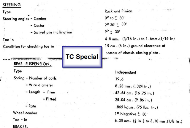

From the manual:
Front
Toe: 3/16 - 1/16 in
Camber: 0o to +30'
Rear
Toe: 1/4 to 1/8 in
Camber: -1o +/- 30' (between -30' to -1o 30')
