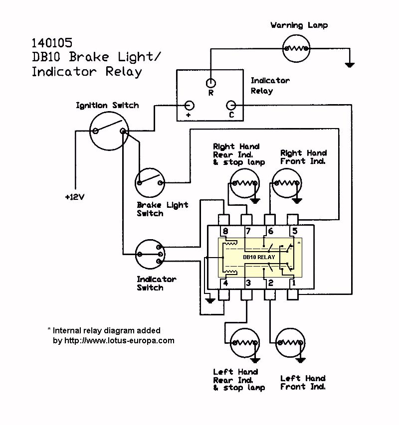

 BDA, here is some info , first.
http://www.lotus-europa.com/manuals/misc/electrical/The%20Lucas%20DB10%20Relay.doc
europa.com/manuals/misc/electrical/DB10.jpg
Try removing the green wire fuse . Since you mentioned the wire is hot. See what you have or don’t have.

Thanks for that write up about the replacement for the good ole DB-10.
You lost me about "removing the green wire fuse..." Can you clarify that. Also please check your links. Two of them seem like dupes and I think I think the europa.com one might be lotus-europa.com... Nice picture of how the DB10 fits into the wiring scheme.

http://www.lotus-europa.com/manuals/misc/electrical/DB10.jpg
the green fuse wire to brakes may be hanging up inside the relay pin 5. And check the condition of the ignition switch white wire.
