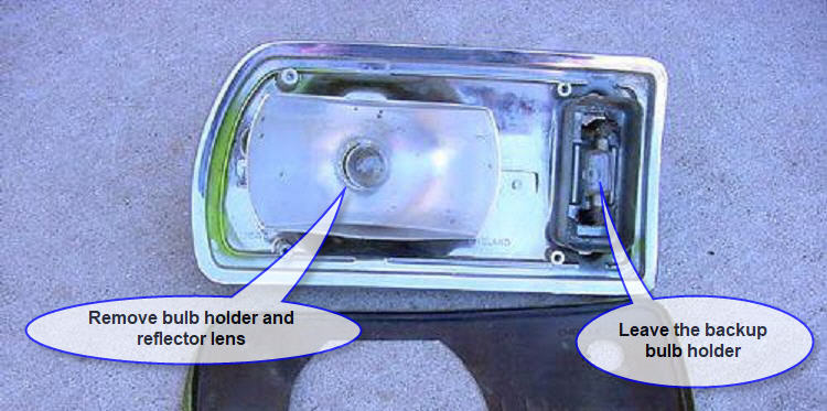

I would be using the stock lens. The backup light remains.
The electronic blinker that I'm using does make noise.
The DB10 relay is no longer needed, as the brake light is separate from the turn signal light (Like a non-federal car).
I would install the flat panels into the existing light housings. I only need to remove the reflector and bulb holder that is there.

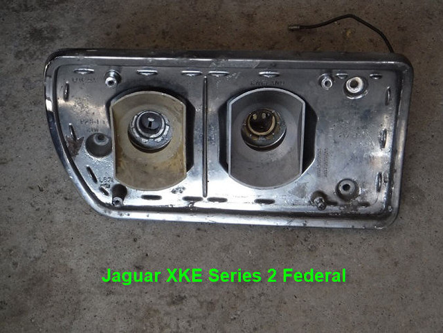

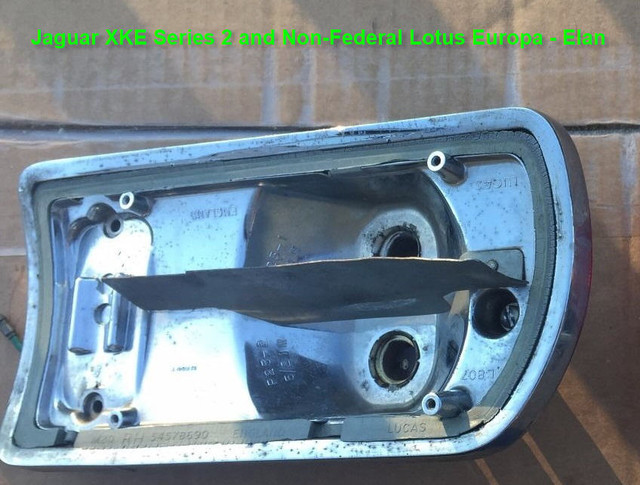

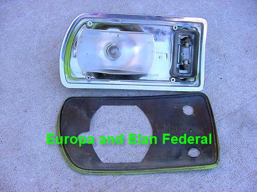

Here are the three different versions of the Lucas L807 housing.
