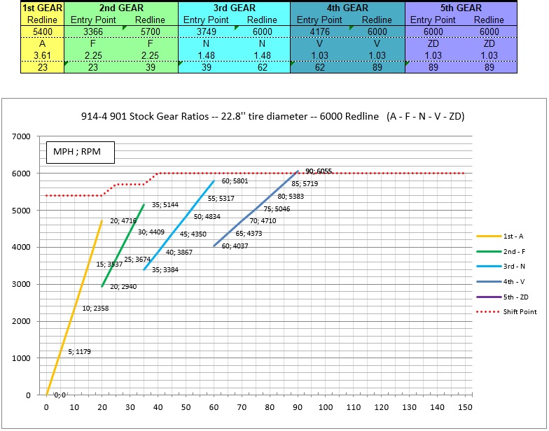

Looks more like top speed at 6,000 RPMs would be 90 MPH
