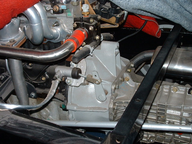

Hi.   This is Dean - HealeyBN7.  Yes I am using a hydraulic slave, but that was driven based on my desire to move to a hanging pedal assembly, not the clutch actuation.
I think you will be very pleased with the Zetec conversion.   I documented some of the changes in the attached file

Here is my clutch setup.
