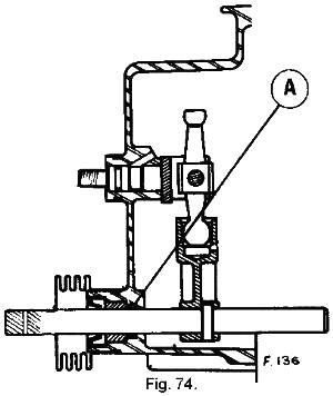

"felt washer (A of Fig. 74) behind the bush"
The seal is on the outside of the bush and easily replaced with the cover on.
